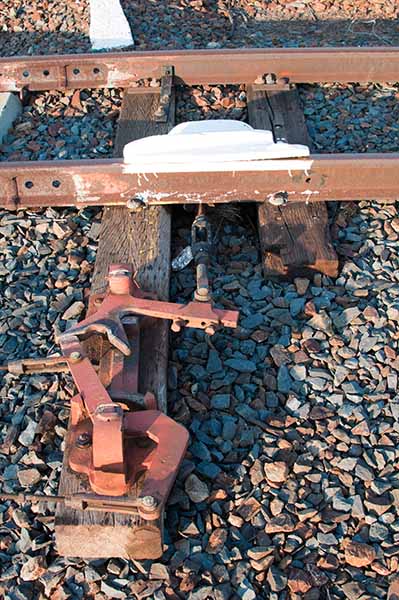

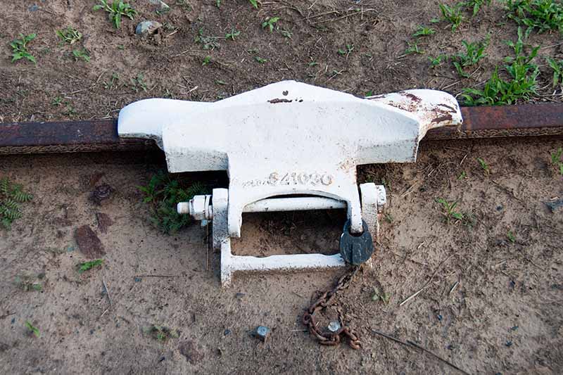

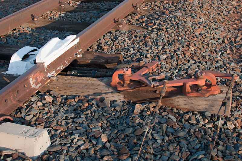

Hi,
A derailer provides flank protection for a line from wagons in a siding. If the wagons in the siding start moving for whatever reason they will hit the derailer and derail so they do not get onto the mailine. The example on these photographs is linked to the points tumbler so when the points are set for the siding the derailer drops of the rail. They are know as "skilpads" by the crews. Interesting on the tumbler is that the bottom casting is stamped CGR, perhaps a survivor from Cape Government railways days.

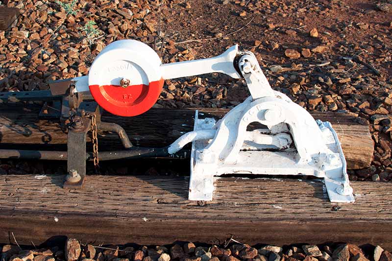

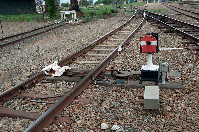

Some more photos of derailers. The derailer with signal is at Rooiwal station on the siding to the grain silos, it is operated from the cabin.
