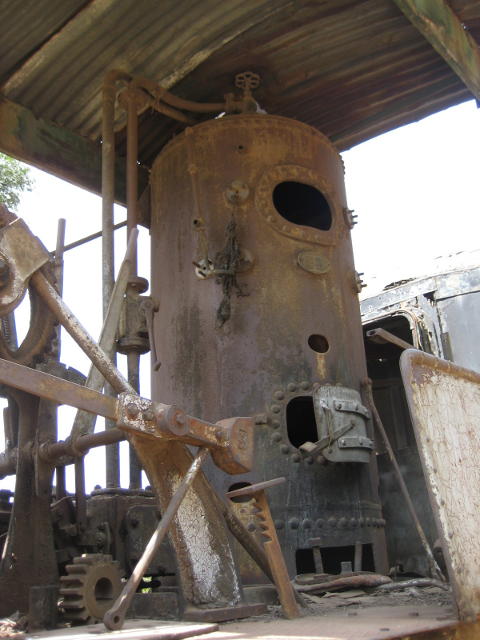

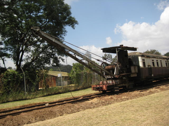

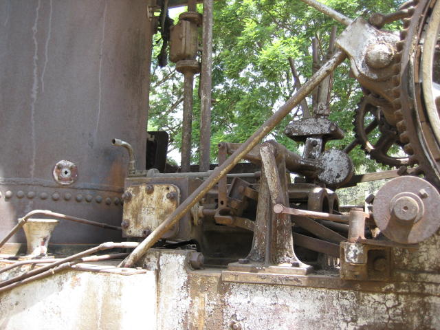

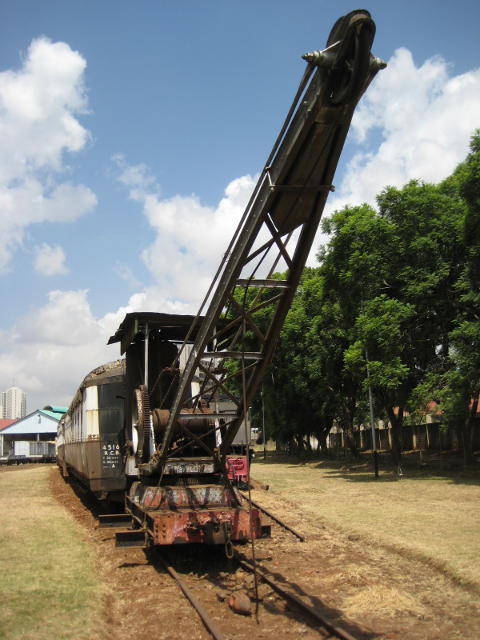

A steam crane has appeared at the museum recently. Maurice rescued it from somewhere in the depth of the workshops.
Photos by John Ashworth, 31/01/11
- crane_IMG_4180.JPG (74.93 KiB) Viewed 24738 times
- crane_IMG_4181.JPG (73.2 KiB) Viewed 24738 times
- crane_IMG_4182.JPG (83.67 KiB) Viewed 24738 times

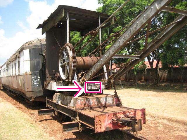

There's no manufacturer's plate on it. I'll try to ask around and see if anyone knows.

EARH No. 1106 Grafton 2 Ton Steam Crane. Circa mid 1920s.
Graftons rarely carried date of manufacture. The works plate usually carried neither works number nor date.
The works number is cast in to the base plate of the crane.
See attached – can it be read from an original photo?
The bases for different sizes of crane were cast in batches of 6 to 10 number and used as orders for that capacity of crane came in. It is thus difficult to be exact as to date of order for some sizes of crane.
Other numbers found on various parts are casting pattern numbers e.g. 312 for the cheek plate of this size of crane – complete with manufacturers name.
This crane is not 630 as it has the later form of revolving carriage.

Thanks, Christopher, for this, and for the information you have given on other cranes. I'll have a look for that manufacturer's plate again next week.
