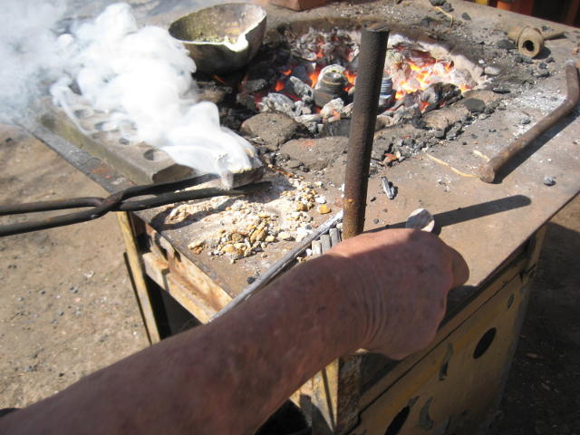

Boiler inspector Des Painton replaced the fusible plugs in 2650's firebox today. An interesting procedure.
Photos by John Ashworth, 14th August 2010

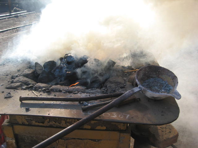

Early in the morning, the fire is just starting, with a lot of smoke.

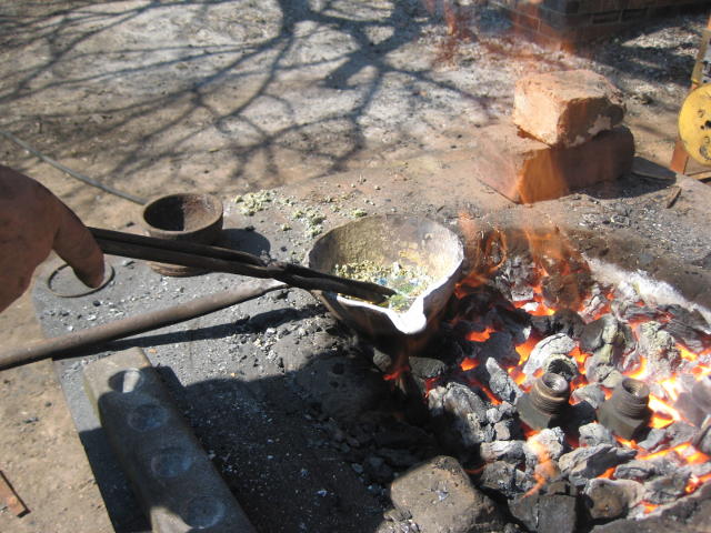

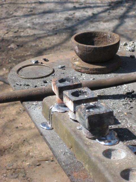

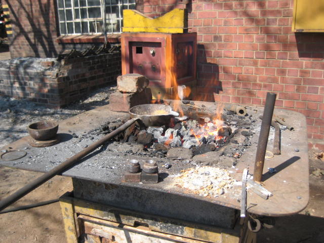

Fanned with compressed air from below, the fire is now hot. The ladle of molten alloy sits on the fire. Two plugs sit at the front of the table.

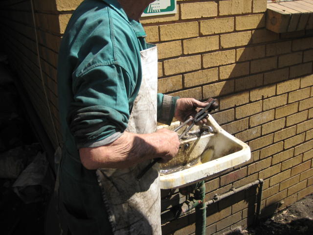

Des flushes the plug under the tap

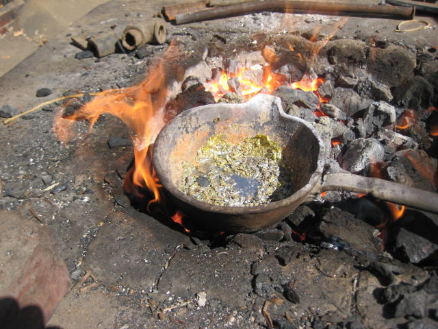

The molten alloy simmers on the hot fire
Des stirs his witch's brew
The heated plug is being cleaned with ammonium chloride, hence the smoke

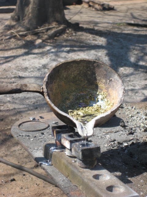

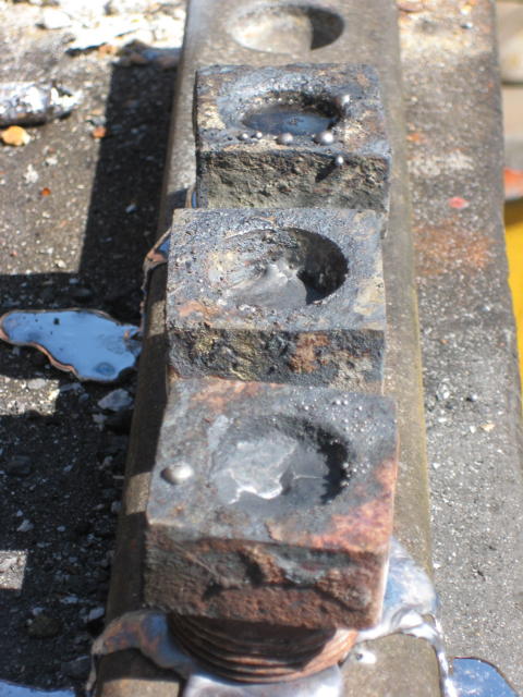

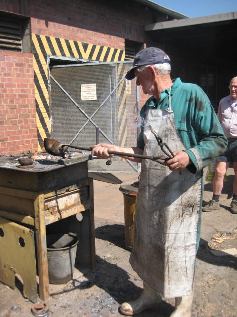

Pouring the molten alloy into the first plug, sitting in its special rack
A picture of concentration - although Des has been doing this for more years than most of us can imagine
Pouring into the third plug

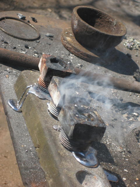

A little spillage
A little spillage
Des has just added a sprinkle of ammonium chloride, hence the smoke
Cooling
Cooling

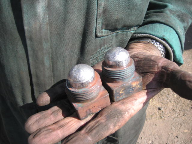

The finished product
