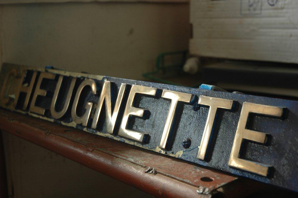

Nathan wrote:I thought a topic with a difference. I have shown the sequence of cleaning and restoring the 2650 brass plates. I have tried to put them in order so it will start with the name plate first and finish with the cabs sides if I got my number sequences correct.

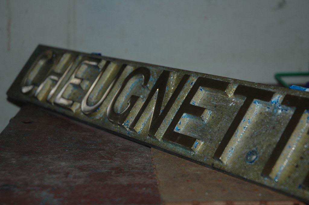

The nameplate, pronounced "CHENAY", has all the old paint cleaned off.
2650 cleaning her up! 044.jpg (77.03 KiB) Viewed 6785 times
CHEUGNETTE nameplate is now cleaned of all the old paint and now will be wiped clean with thinners. Then a release agent will be painted onto the lettering that must remain as visible brass, whilst the rest will get the paint on it that will form the background.
2650 cleaning her up! 045.jpg (70.08 KiB) Viewed 6785 times

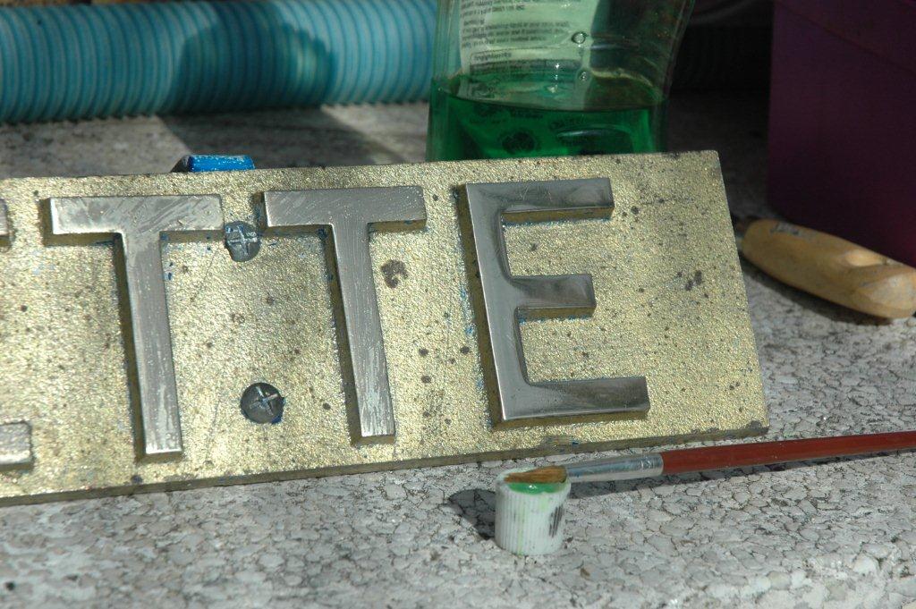

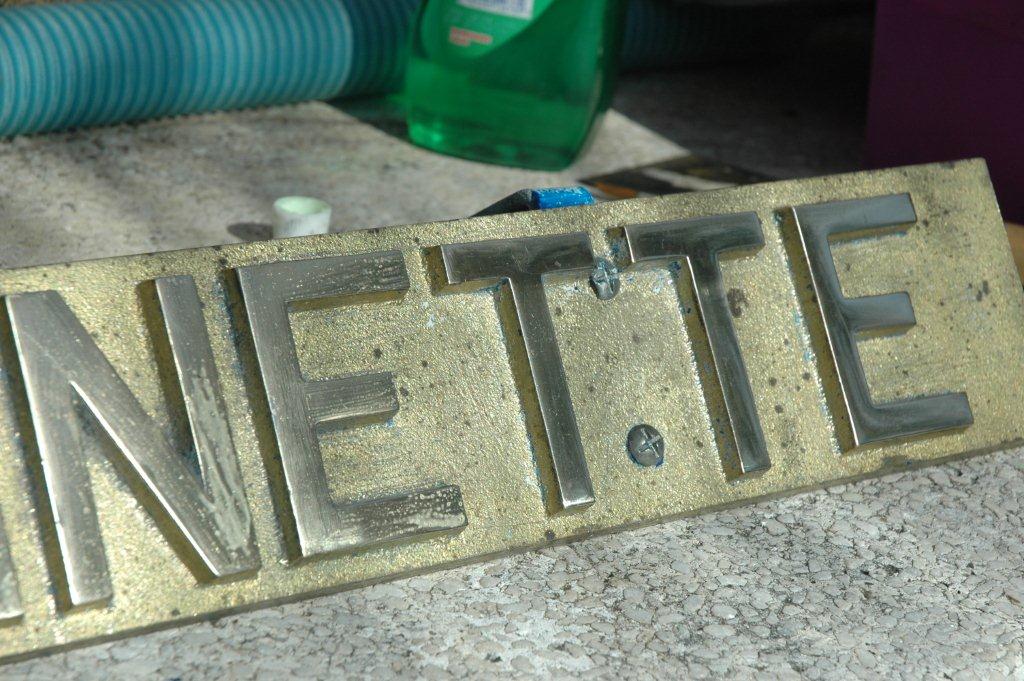

I now use a dishwashing liquid or one can use soap, as a release agent. I apply it with an artist brush.
2650 cleaning her up! 047.jpg (147.69 KiB) Viewed 6785 times
Here we can see the dishwash liquid painted letters and those that still need the liquid to go on as release agent.
2650 cleaning her up! 046.jpg (143.06 KiB) Viewed 6785 times

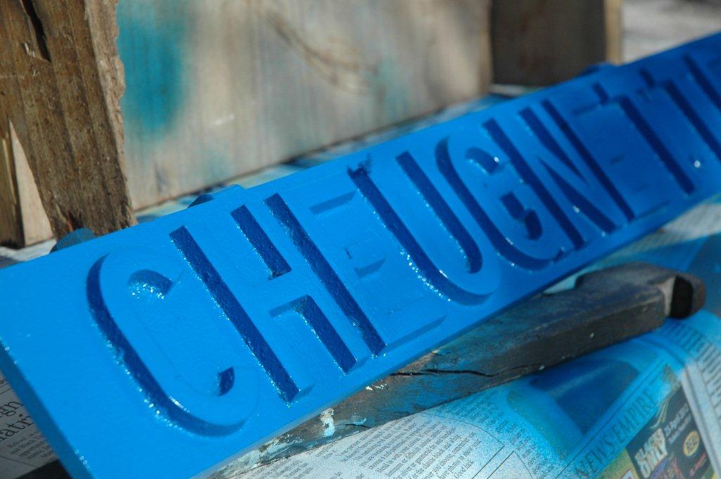

CHEUGNETTE is now completely sprayed with paint from a spray can. Electric Blue, in this case. When the paint is properly dried, it will be carefully removed from the lettering.
2650 cleaning her up! 049.jpg (83.49 KiB) Viewed 6785 times

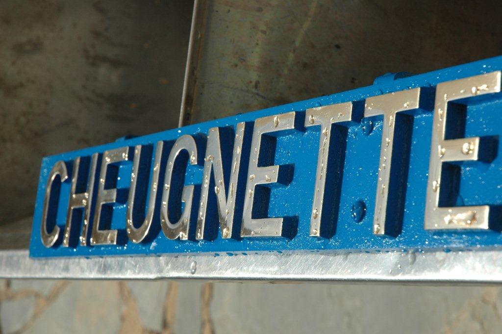

With water on it, I find it easier to scratch the lettered paint off by using my fingernail. The water will wash the dishwash liquid away and it actually leaves the brass shinier than using soap.
2650 cleaning her up! 051.jpg (73 KiB) Viewed 6785 times
The nameplate is now completed and will dry and soon will be mounted on the headlight bracket of the 19D.
2650 cleaning her up! 053.jpg (89.89 KiB) Viewed 6785 times

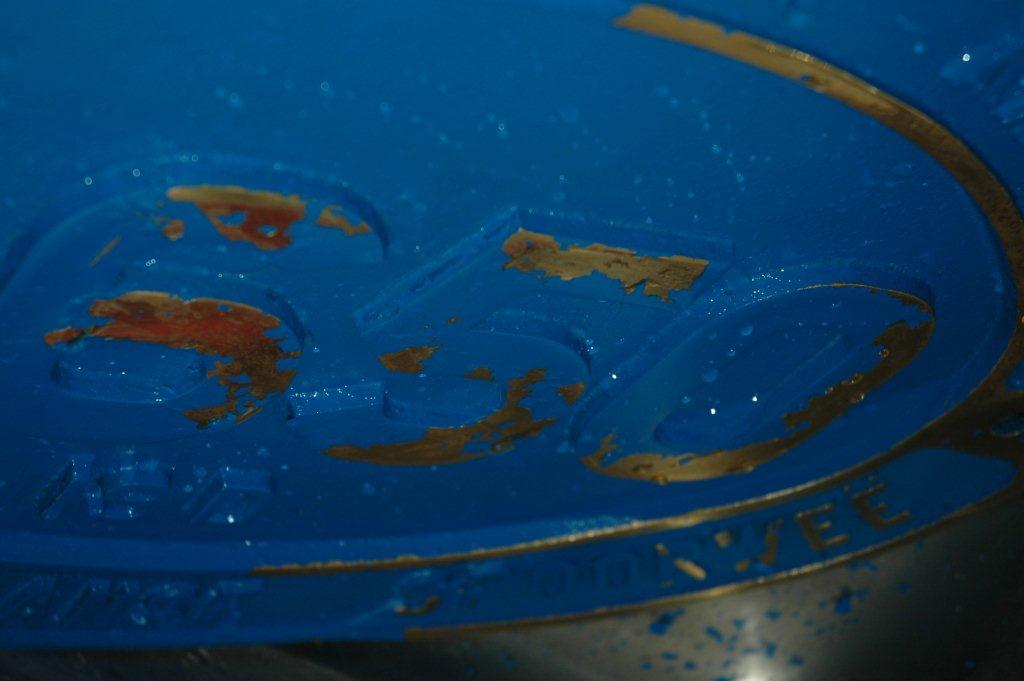

Here we repeat the process with the cabside plates. Clean, release agent and spray.
2650 cleaning her up! 001.jpg (113.4 KiB) Viewed 6785 times

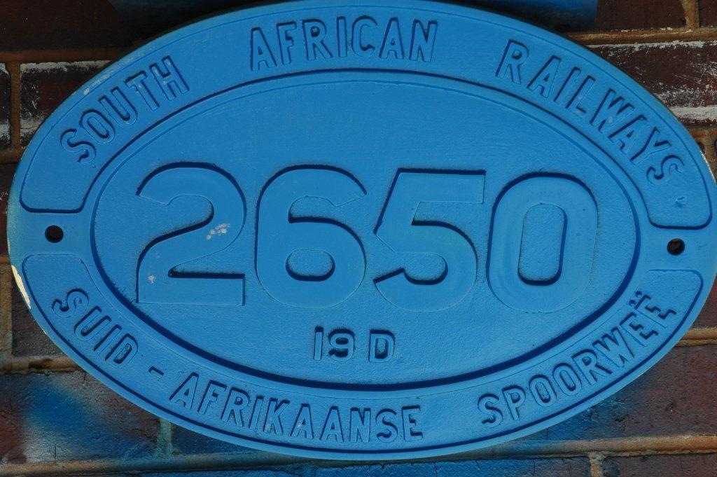

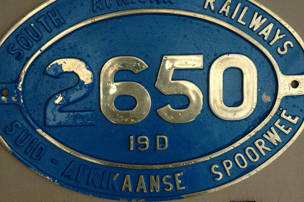

The brass lettering now appears after slowly being removed with my finger nail and water!!
2650 cleaning her up! 002.jpg (52.11 KiB) Viewed 6785 times
Getting closer now and looking good.
2650 cleaning her up! 003.jpg (145.59 KiB) Viewed 6785 times
Before and after. One cabside complete and one to go. Lots of hard but rewarding work, but to keep them clean!!
2650 cleaning her up! 005.jpg (91.62 KiB) Viewed 6785 times
